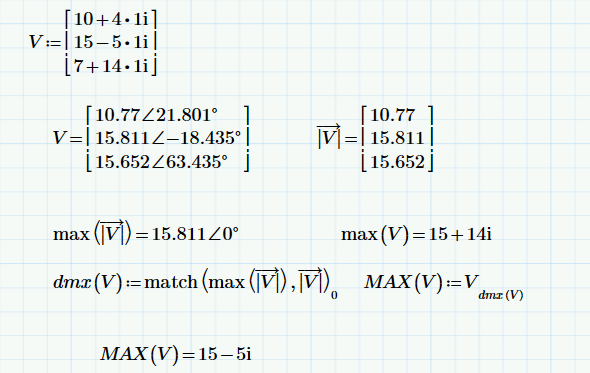

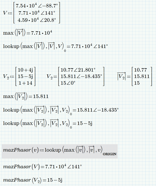

Heres a one-line solution:
P.S.: I don't see why the method used in the Mathcad 15 version file frome here Vectors with Complex Numbers in Mathcad - PTC: Mathcad - Eng-Tips you had linked to should not work the very same way. After all its basically the same what Fred had shown above.
EDIT: Lets give it a try:
Bingo! Works the same way 😉

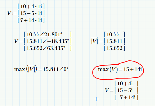

23-Emerald I
December 1, 2016
This is truly strange:
18-Opal
December 1, 2016
That is because the max function picks  the max real and max imaginary.
23-Emerald I
December 1, 2016
Seems like a bug to me.  You could build a "work around" by finding the index of the matrix of amplitudes.
