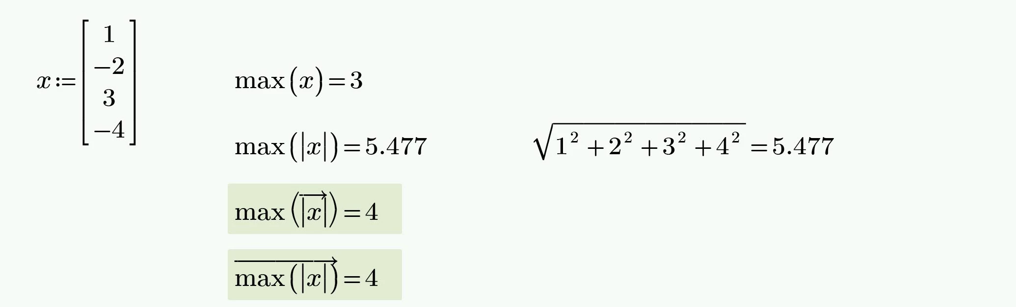

I need to get the max values using max function regardless if there are positive or negative , how ever when I use [ I x I] I get different numbers , how can I get the max ?
You don’t show what you are doing o how should we know?
Chances are that you need to vectorize as otherwise |x| will give you the magnitude of vector x.

If you want all in one picture, then grab a screenshot and paste the interesting portion of that:
Note that this is a limitation of Prime, because from Mathcad I can do it without intermediate steps:
