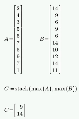

There sure is a way to do what you are asking for, but its not clear to me what exactly you need.
Best you provide some samples in a worksheet, state what result you are expecting and attach the sheet here.
What I understood from your short question was, that you want to find the maximum of the first and the maximum of the second vector and want the two values returned in a 2 x 1 vector.
Could be done that way:
P9 worksheet attached

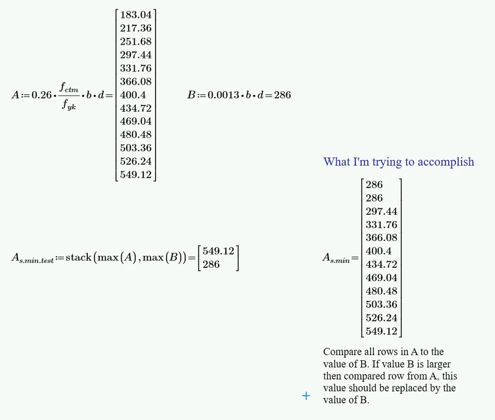

8-Gravel
Apr 24, 2023 7:04 PM UTC
Skjermbilde 2023-04-24 kl. 20.53.17.pngHi Werner, thank you for you're reply.
I've attached my worksheet, with a workaround solution I created to solve this issue. The attached image is from the second page.
