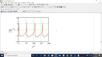

I have a series of plots similar to the one below with multiple peaks and troughs. I want to get the values of the peaks and troughs and their x coordinate. The only way I can think to do it is to use max to find the value of the biggest peak, remove that section of data, find the next and so on. This is tedious and I have many to do. There must be a better way. Can someone show me what it is. Worksheet is attached.

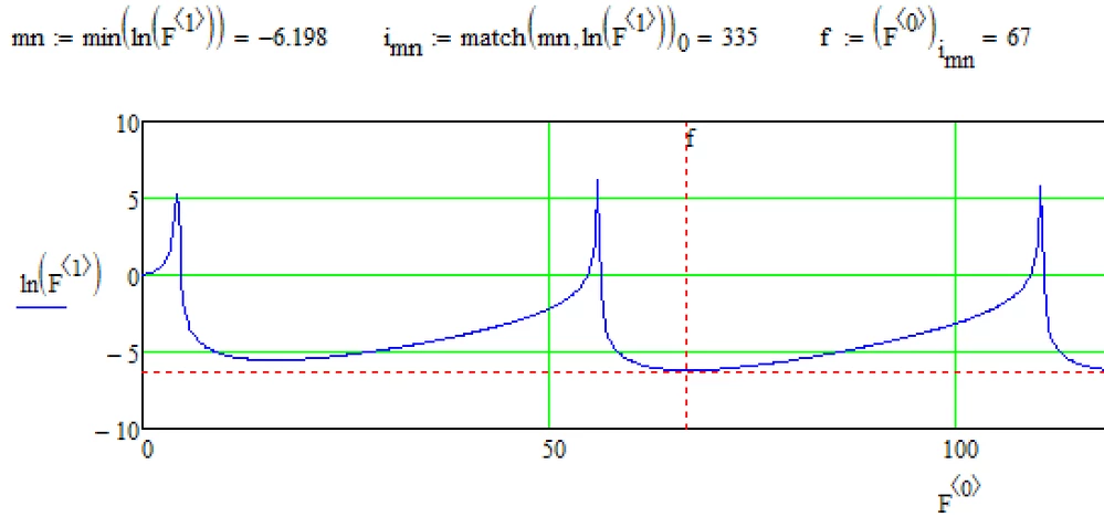

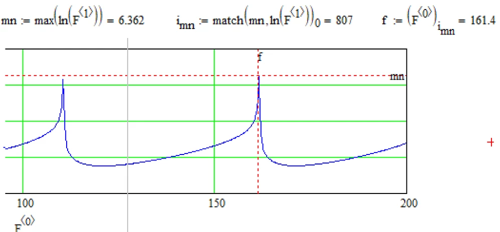

HI,
If you do not have the data extension pack you can resolve the minimum and maximum.
Sheet is enclosed.
Regards
Terry

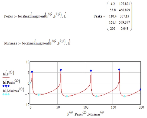

Thanks for your reply, Valery. Probably my question was not clear. In addition to the value and position of the highest peak (and lowest trough), I want to get the maximum and minimum values of all the peaks and troughs (i.e., four of each in the example shown).

 How about using Mathcads "localmax" function (from Data Analysis Extension Pack)?

As far as I know the DAEP is part of every Mathcad distribution since MC14, apart from some single user edu licences, where the pack and its help is also installed during installation but the license for it is missing. In Prime its integrated anyway. Did you give it a try?
But in case you are using an older version of MC (from the pic you posted it looked like MC14 or MC15 anyway) or have a version without a license for the DAEP, its not hard to recode those functions. You will find examples how to do here in the forum, as an example
https://community.ptc.com/t5/PTC-Mathcad/Improve-localmax-results/m-p/546078/highlight/true#M179863
or
https://community.ptc.com/t5/PTC-Mathcad/Gaussian-fit-to-several-peaks/m-p/147888/highlight/true#M58106

Clever. Thanks.
