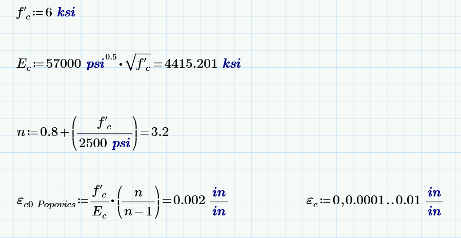

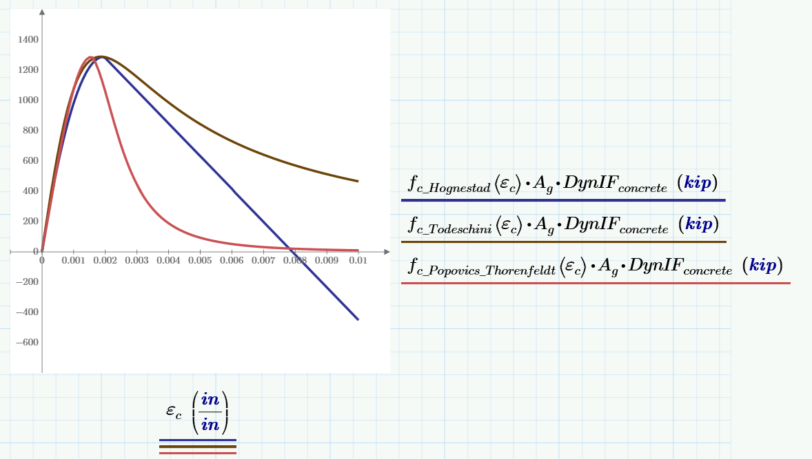

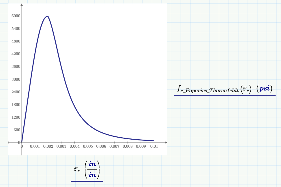

Hi I have the following graph functions. However I want to get the maximum f(e) value but I do not know how to do it.
How do you obtain Maximum value and minimum values of f (y axis value) and e (x axis value) respectively. same for minimum value.
And how can you do this within a specified range. I tried to do this but it does not work.

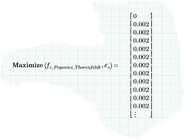

I only want to get a single value. I do not know why I get a matrix.

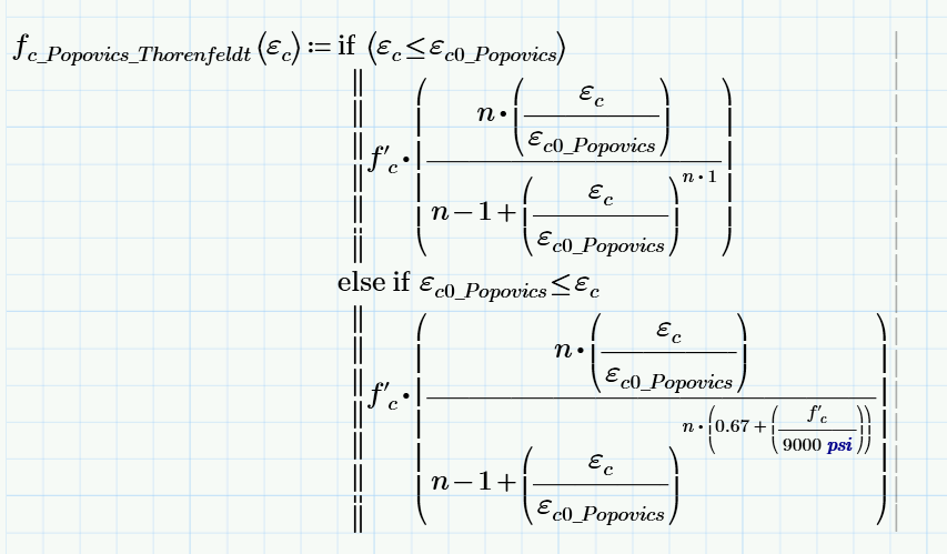

QU9F1.pngQU9F3.pngQU9F2.pngThis is the function.

You have already been told how to do it. Use the maximize function. Use a single guess value, not a range variable.
