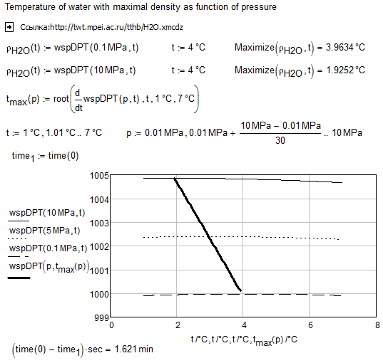

Maximize/Minimize or Find a root (zero) of derivative
I can use the Maximize function for a finding only a one point.
And I must use the root function (not Maximize) for the creating f function.
Can you help me to use only the Minimize function here.
The problem: root(y(x), x) but Maximize(y, x)
See the picture and the Mathcad-sheet with cloud functions in attach.
16 replies

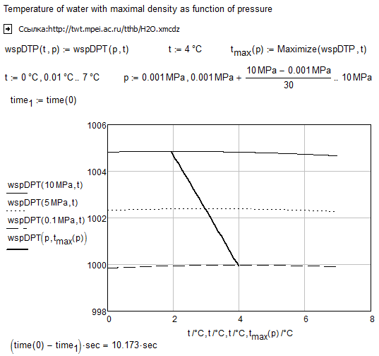

Is only a matter of the order of the parameters.
The following works about more than ten times faster than the root version (which seems to be the reason you wanted a maximize version, I think).
Ich bedanke mich herzlich, Werner!
z(x, y) is not equal z(y, x)
