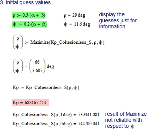

I am trying to solve a nonlinear equation for the maximum value.  The equation is from Bowles, Foundation Analysis & Design, 5th Edition, Chapter 11-7, page 609, Eq. (11-10).
I am interested in the maximum value of Kp for a given guess value assigned to two variables, rho and psi.  I have tried defining the function before executing the Maximize function and have not had any success finding the maximum value of Kp.  The Mathcad file is attached and I would appreciate any comments regarding format/syntax errors.
Please note that all the soil parameters are fixed and the maximum value for the function is the desired result.

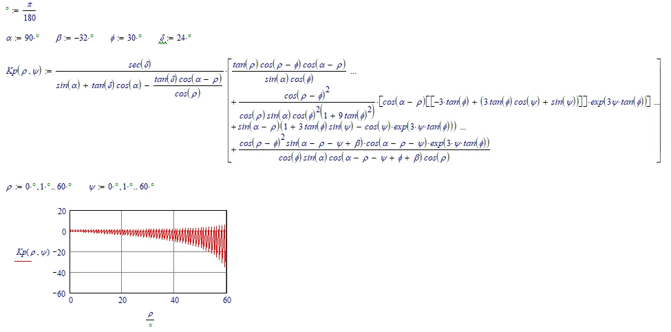

This is what the function results are over a broad range of rho and psi:

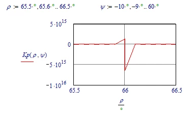

But when you go a little further you can find this:
Which means I've found a 'maximum' near rho=66 degrees, and the value of psi doesn't (seem to) matter. The maximum is about 1.3E15. Very (too) big. Your function diverges and I guess using Maximize will not work, because it is bound to find this, and possibly other points where the function wil explode, probably due to division by zero...

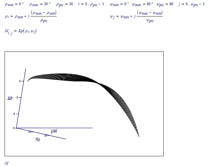

Created a surface plot that shows there must be a (local) maximum for rho and psi both < 60 degrees.
Are you looking for something like shown below?
Note that you don't have to use a solve block (Given) as you don't have any additional constraints but of course you can use it - it will make no difference here.
When using maximize you also have to add which variable(s) Mathcad is supposed to play with and the result are rho and psi values.

I've calculated the derivative of your formula and it NEVER gets to zero for any set of values of rho and psi  between 0 and 60 degrees. When you plot your formula on a surface for low angles you can see that it drops off along the psi axis, but only rises with rising rho along the rho axis. That's why Maximize will run towards the 66 degrees maximum for rho (while psi can be 0).
From the description of the book, and looking at the formula in the book compared to what you've entered in Mathcad, I think you need more.
You need to enter both polarities of the formula and work from there.
You can create the Ka and Kp formula easily from your formula for Kp_C(rho,psi,p) by adding, say p, as an extra parameter and inserting/replacing a multiplication with this p everywhere a +/- is and a multiplication with -p (minus p) everywhere there is a -/+. Then Kp(rho,psi):=Kp_C(rho, psi,1) and Ka(rho,psi):= Kp_C(rho,psi,-1).
I'd suggest you then thoroughly investigate the surface plots of Kp and Ka, to find which (if one) of the two solves your problem satisfactorily. Then you might be able to apply Maximize successfully.
