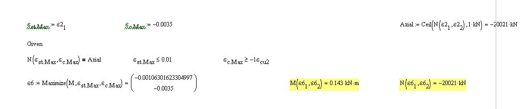

Maximum Function Constrain with Range Variable
This Maximum function has one of the constrain Axial=20021.kN and it works fine
Now I am trying to achieve if the Axial is a range variable Let say -20021.kN, 20000.kN...0.KN and other constrains remains the same and to find the respective Maximum values
I am wondering is it possible at all in MathCAD

This actually does require a little trickery to make it work. There's no way you will be able to calculate so many values though. At least, not unless you are willing to wait a month for the calculations to finish

Yes, this should be possible. The solve block needs to be turned into a function of "Axial". It may also need to be a function of the other variables, so that you can pass it different guesses that depend on the value of "Axial".

I am afraid I would need your help.
I am not that wise enough to get that working
Please find the attached.
