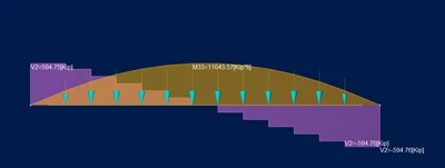

Maximum Moment Calculation Multiple Loads

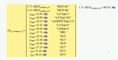

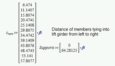

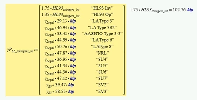

Does anyone know of a more simple equation to derive the max moment of a simply supported beam. I have 12 equally spaced loads with the first and last being spaced further from the support than the typical spacing. Exterior loads are different from the interior. Heres some pictures of what im working with. The BMD diagram is my check for the moment of the HL93 Inv Loads. I've done this before when only working with a couple concentrated loads but the formula would be to long for this. Would also like to be able to check the moment at any location along the beam

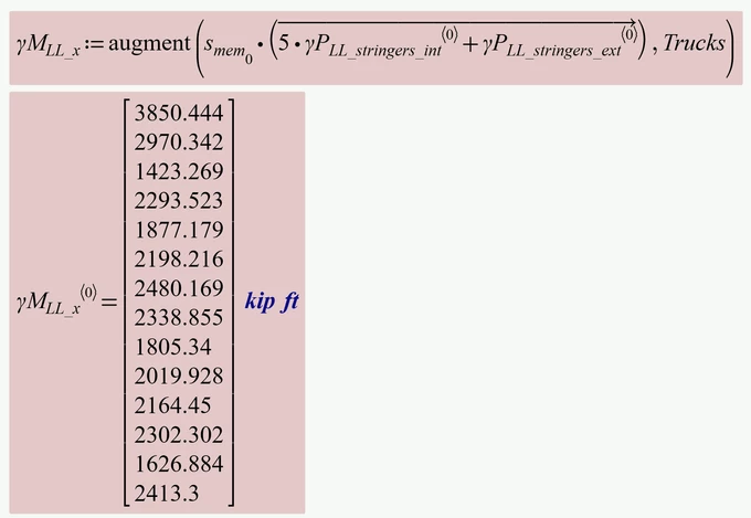

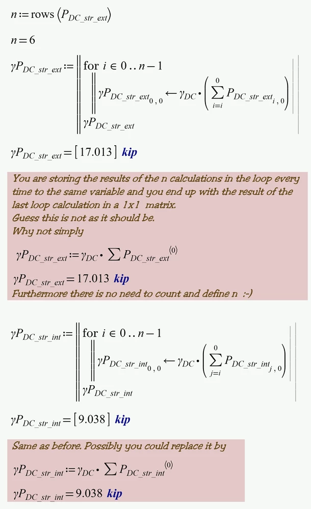

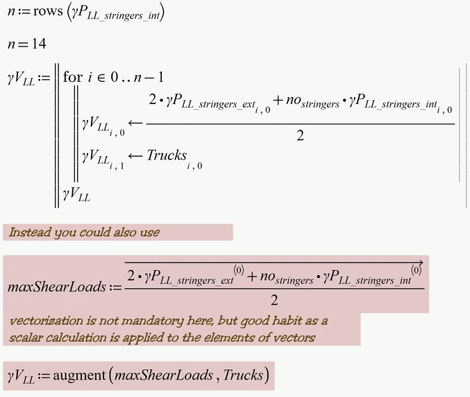

Oct 11, 2024 5:15 PM UTC
Unlike Terry, I have no idea about your area of expertise, so I just looked through your worksheet and noted where I thought something could be made easier.
and then
EDIT: Added gammaM.LL_x, which was missing in the sheet you posted
sheet attached

thanks werner that helps out. I still cant figure out figure out how to correlate terry's sheet with mine. His defines specific loads to each distance where all mine all the same for those interior locations. Thats what im having trouble putting together.
