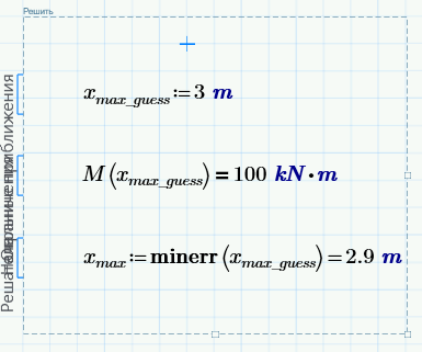

Use the old good function MinErr
23-Emerald V
