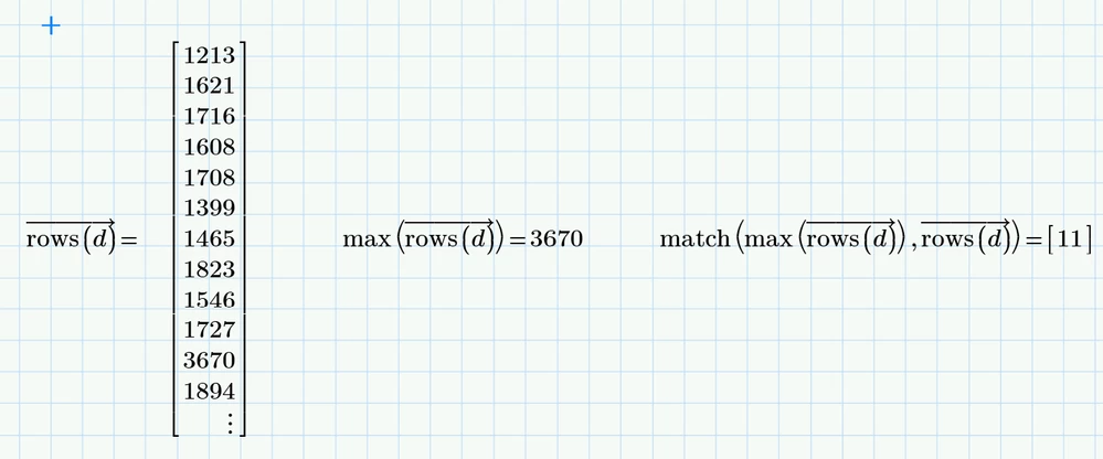

@YA_10963798 wrote:
How can I find the longest vector. I have q which has 27 vectors and I want to find the longest vector which has the most values . maximum function works only for scaler not vectors . this is on the  2nd page of my sheet
Different array, same process.
Stuart
Thanks a lot
