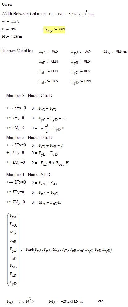

I am having issues with the "find function". I am trying to solve for the reactions of the structure in the attached file. I've been wrestling with it for a while now and am finally asking for help.
Despite my units working out in the equations, MathCAD refuses to solve it. I am not sure what I am doing wrong.
Some advice would be greatly appreciated.

Two errors:
1) You use P and P.bay in your equations, but P.bay is not defined. Either you forgot to define it or meant it to be P.
2) After find you use an equal sign, which would force Mathcad to display the result vector. But you variables are of different dimensions - M.A is Energy (Nm), but all the others are force (N). Mathcad unfortunately does not allow quantities of different dimensions in one matrix.
So simply delete the equal sign and evaluate the variables one by one.

Thank you!!
That helped greatly.
