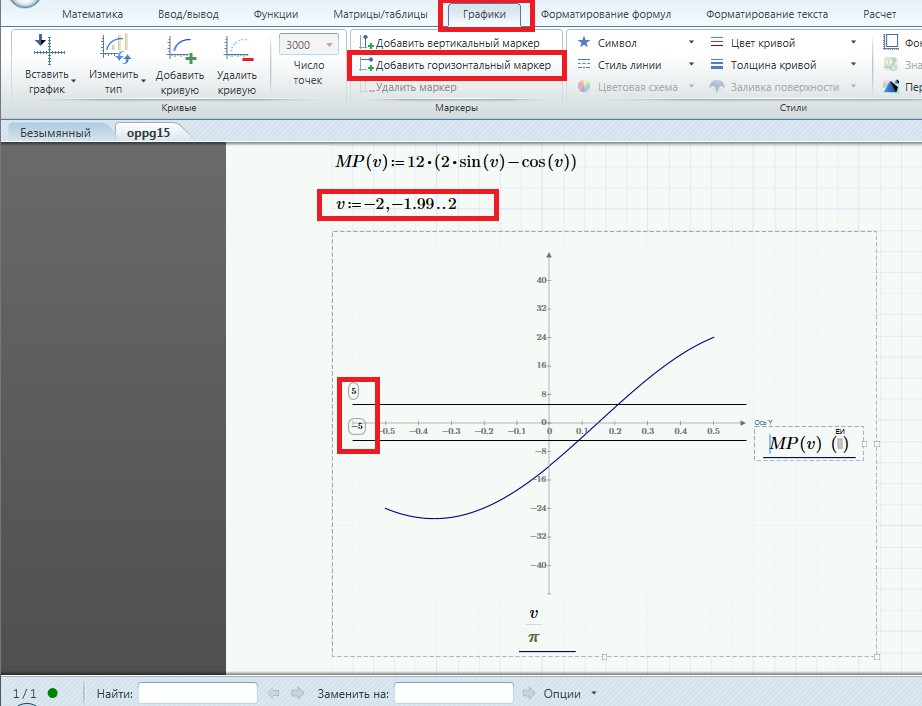

Why can't I produce this plot in MathCAD Prime 3.1?
MathCAD Prime truncates the plot!
The prime file and pdf images from Prime and MathCad 15 are attached
You need to determine the range of the variable "v" for the plot. Also you can add horizontal markers from the "Plots" tab.
