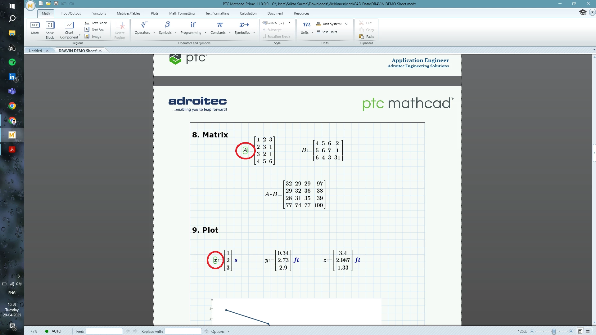

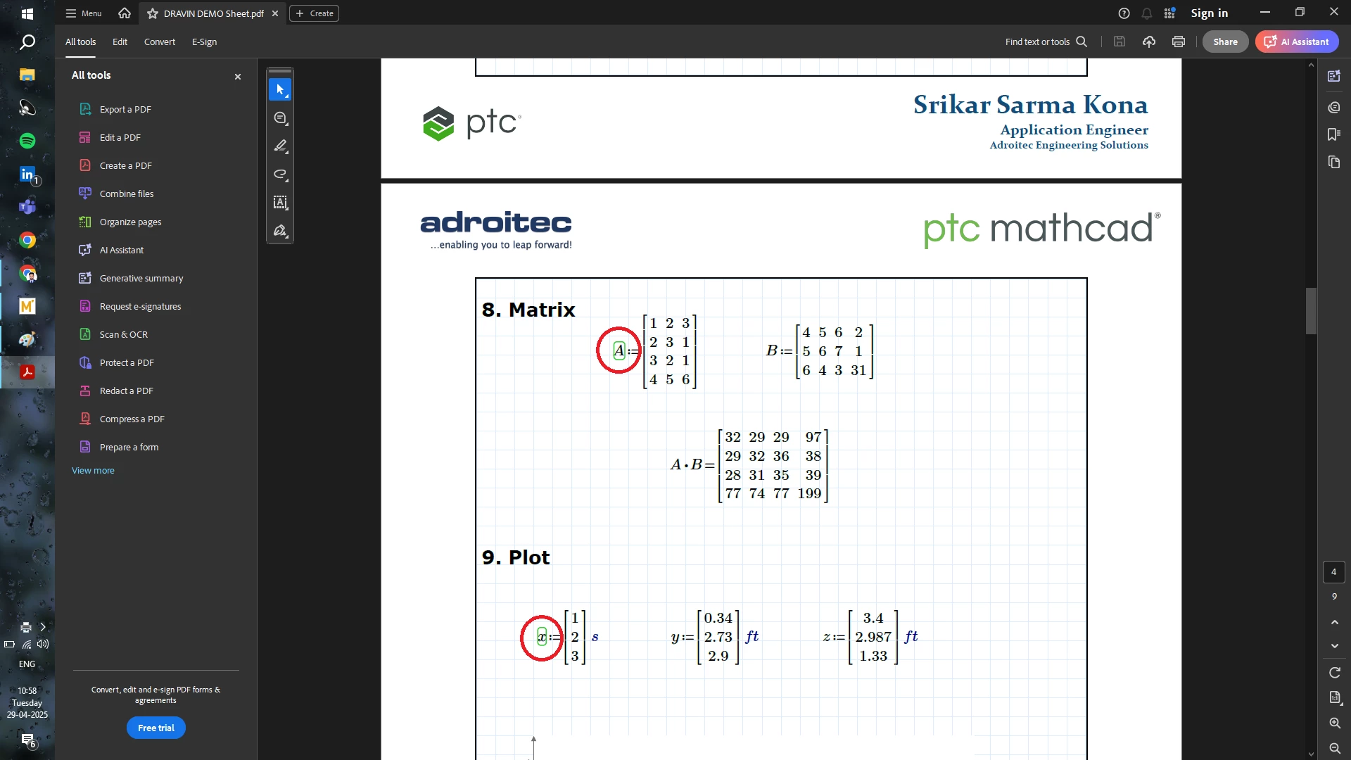

When I try to export a mathcad worksheet to PDF file, all the green (no error) boxes are also getting exported. Is there any way to hide then or switch it off when I export from mcdx. to pdf.? It`s a bit annoying when any of my clients see it that way with green boxes rounded off at random places.

Those green boxes are warnings that you're redefining a variable. You can switch that off by a setting, look for warnings on the 'Calculation' tab.
