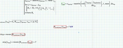

Hi everyone,

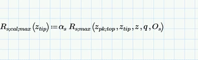

I have this function that I used to find R from it

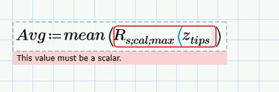

Now I want to find the min, max and max  from it ..but didn't work . It tells me that the values should be scalar
and when I do this , it gives me the same results of the original one not the average
I need to find the min, average , and max values
Yusra

Hi Yusra,
Your z.tips is a range, not a vector. Applied to a function that makes the function result a range at best, but not a vector.
 Try making z.tips a vector, e.g. with:
and vectorise your expression:

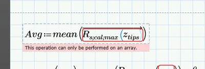

Jan 7, 2026 10:15 AM UTC
It didn't work, do you think I'm missing something?

Jan 7, 2026 10:25 AM UTC
Don't vectorise the other expression:
