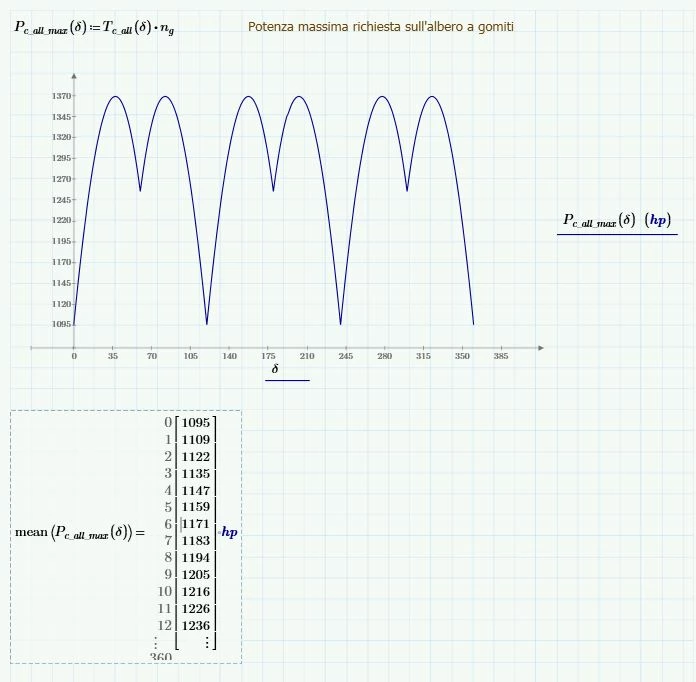

Good morning.
I have a function with the variable working into a closed interval; I'd like to find the MEAN value. Using the function MEAN, this function is getting out the save values of the function.
How could I do?

23-Emerald I
October 2, 2018
@Andrea4505htown wrote:
Good morning.
How could I do?
The function mean works on vectors.
Integrate the function over the entire interval, and divide by the length of the interval.

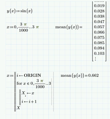

October 2, 2018
See please! If you can not use a range variable - do not us it!
October 2, 2018
You missed a pi
