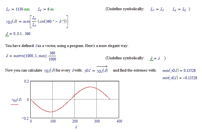

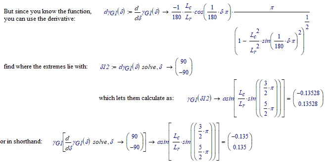

Yes, great! But there's more than one function in there.
Assuming you want the extremes of gamma.G1, here goes:
Note that I'm just inserting pictures, because I don't have a full Prime. (I'm limited to Express, which means no programs, no symbolics, no means and other silly limitations.)
So you will have to recreate this yourself in Prime 5 (which is a good exercise by the way!).
P.S. I noticed that you have a VERY poor display of numeric values set in your sheet. All numbers are displayed with no fractional parts. This can be very confusing. Take care!

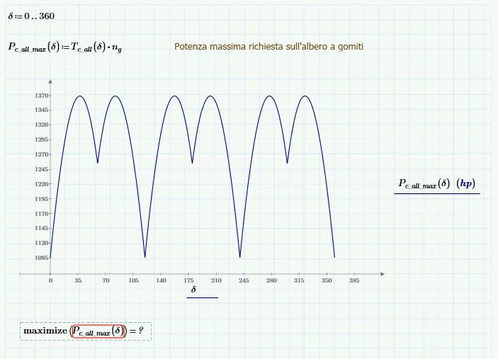

October 3, 2018
Its hard to work with pictures so you sure should attach your worksheet if possible.
One suggestion:
1) below the plot write δv:=δ= (the last evaluation = is important as is turns the range into a vector).
2) Change the "maximize" in the expression below to "max" and the "δ" to "δv"
Did this do the trick?
If not, you may have to vectorize the function call  "P.c_all_max(δv)".
Thats the operation which is shown as an arrow over the expression.
