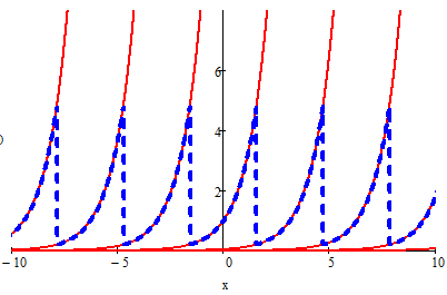

You sure have plotted that sick function and wondered why it looks the way Mathcad is showing.
The answer is (again!) AMBIGUITY - I guess I've mentioned that once or twice. And this time its not the complex domain but simply the atan-function (you may add pi to the result as many times you like).
The min obviously is 0, the real max is infinity of course, Mathcad's max is exp(pi/2).
Look at the plot below:
Red is your function (rather: relation) from a mathematical point of view - an infinte number of exponential functions,
Blue is what Mathcad turns your "function" into as it tries to make a unique function.
atan(x) will only return values from -pi/2 to pi/2. Thats the reason the blue curve has a max at exp(pi/2).
So in Mathcad atan(tan(9*pi/4))=pi/4, while mathematically its pi/4 + k*pi, k=integer

Many functions and operations in mathematics do not yield a unique result but more than one, maybe even an infinte number. You encounter this effect very often especially when you deal with complex numbers (exponentialisation of a complex number or taking the logarithm of a complex number). But also if we stay with real numbers only, we have functions like the arcus function which yield not just a single unique result. Pocket calculators usually decide to select just one of those results, often called the principal value. Mathcad does so, too, most of the times.
This is exactly what I was just talking about. Draw a unite circle and look where 9*pi/4 is located, or 17*pi/4, etc. They all are at the very same postion (pi/4, 45°). So the tan() of all those values is the same (1). When you now take the atan(1), all those values are valid results, so atan(1)=pi/4 + k*2*pi. But what about 5*pi/4 (or 13pi/4, or -3pi/4,...) They also are located at the same position (225°) and their tan() is also 1 (tan(x) has a period of pi). So atan(1) is also -3pi/4, 5pi/4, 13pi/4, ...etc. So combining all the above gives us that atan(1)=pi/4 + any integer multiple of pi. And atan(tan(9*pi/4))=atan(1)=pi/4+k*pi, k=integer.
Great! Matcad's symbolics is aware of two kinds of ambiguities here (most often it is not) and so using "fully" yields even a mathematically correct general result. But the check must fail because of Mathcad's attempt to yield unique results (which is a good thing given what Mathcad is made for).Let alone the complex result you selected. Lets chose more simple x=pi, which is a solution of your equation, too. (_n=1, _k=0).
When you check, Mathcad first calculates tan(pi). The result is of course 0 (thats unique). Then Mathcad has to calculate atan(0). Mathematically atan(0)=any multiple of pi= .....-3pi, -2pi, -pi, 0, pi, 2pi, 3pi, .....
Any of those values is a valid result - what should Mathcad do? Not surprisingly it selects 0. atan(x) defaults to the range (-pi/2; pi] as its also the case with most/all calculators. So your expression gets e^0-e^pi=1-e^pi and not 0. Thats life! In other words D(pi) has an infinite number of results, one of them is 0, one is 1+e^pi and there a lot of otheres, too.
