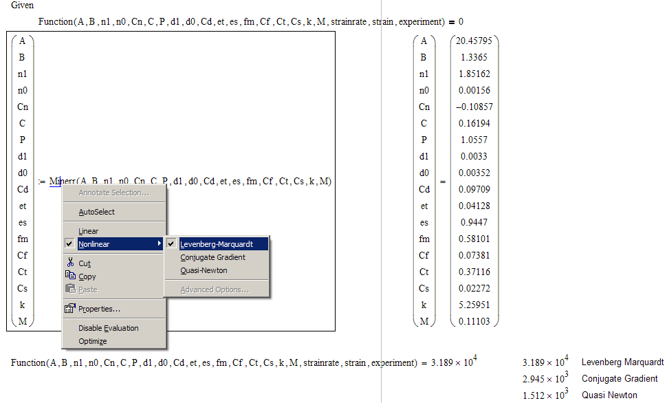

I tried to minimize the objective function above, using Minerr function in Mathcad.
and i put the guess value of 18 variables
and then finally i could get the  optimized value of them
but i am not sure the work i done is right or wrong, so i need a check.
can anyone can check my work?

At first it looks rather strange that you write 1=1, etc. This does not make any sense - delete those regions.
I haven't looked at the upper parts of your worksheet how your functions and vectors are defined and derived, but concerning Mathcad syntax you had done it right. You end up with a set of 18 values which makes your function "function" yield 3.189*10^4 as result. Not zero and I am not sure if this is OK for your application.
In Mathcad you can chose among several algorithms used by right clicking the word "minerr". The default is Levenberg-Marquardt and usually thats a good choice, but sometimes other algorithms may give better results. I tried with your values and here the simple Quasi-Newton seems to give the best result (1512).

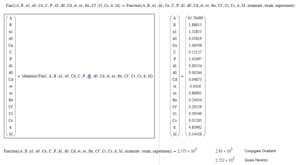

You may also consider to use "Minimize" instead of "Minerr". Using the same guess values we get this:
Of course guess values can influence the outcome as well and you may experiment by using the outcome of  Minimize as guess for the MinErr algorithm. Not sure if this would give you better results.
