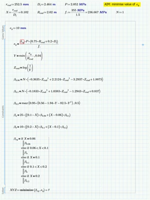

Minimise value in solve block
I am looking to find a minimum value of 'ey' within a solve block based on a set of equations, which otherwise give a circular reference.
So far I cannot manage for the solve block to give me an answer and I was looking for some help.
Screenshot of problem:
Using PTC Mathcad Prime 8.0.0.0

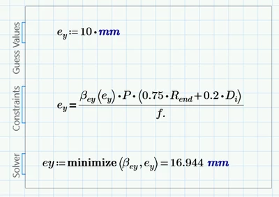

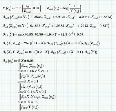

A little more tweaking:
gives:

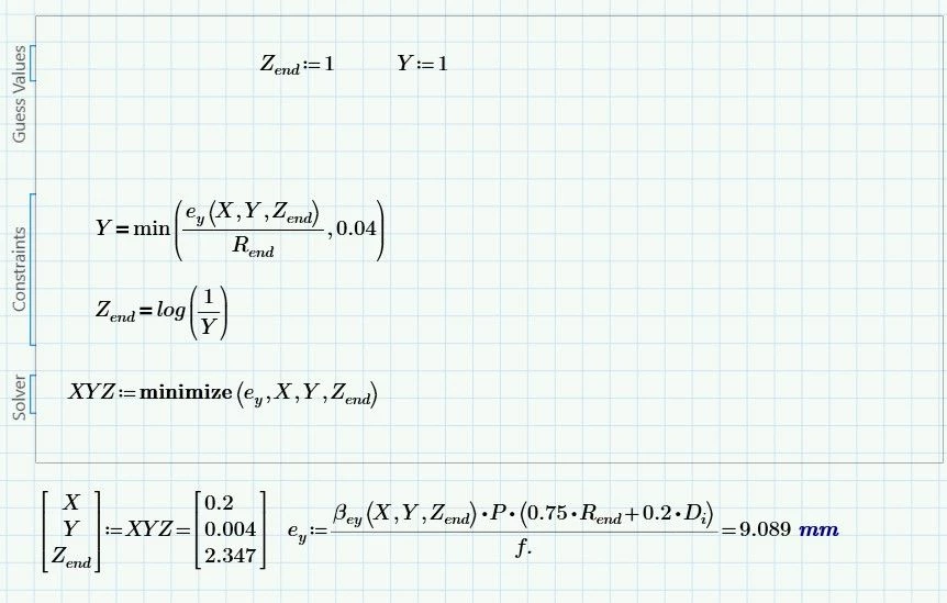

Only have version 9.

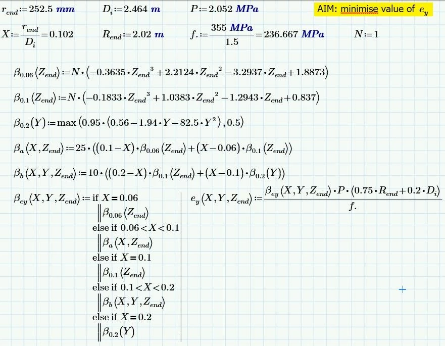

Take all the functions outside the solve block
Define a function for ey the function to minimise.
Set ey as the thing to minimise
LucMeekes23-Emerald VAnswer
23-Emerald V
In Prime 7 I get an error message, that it can't find a solution.
gives:

It looks like you will have to supply additional information!
Which quantity should be as small as possible? Is it e.y as Terry had supposed or is it beta.ey as Luc had?
Also necessary: Which of the variables you defined may be varied to achieve this goal? Terry varied X,Y and Z.end while Luc varied e.y.
Generally you have to know that the quantity you would like to minimize must be a function depending on the quantities you are willing to vary to achieve this goal. You can't minimize a variable.
