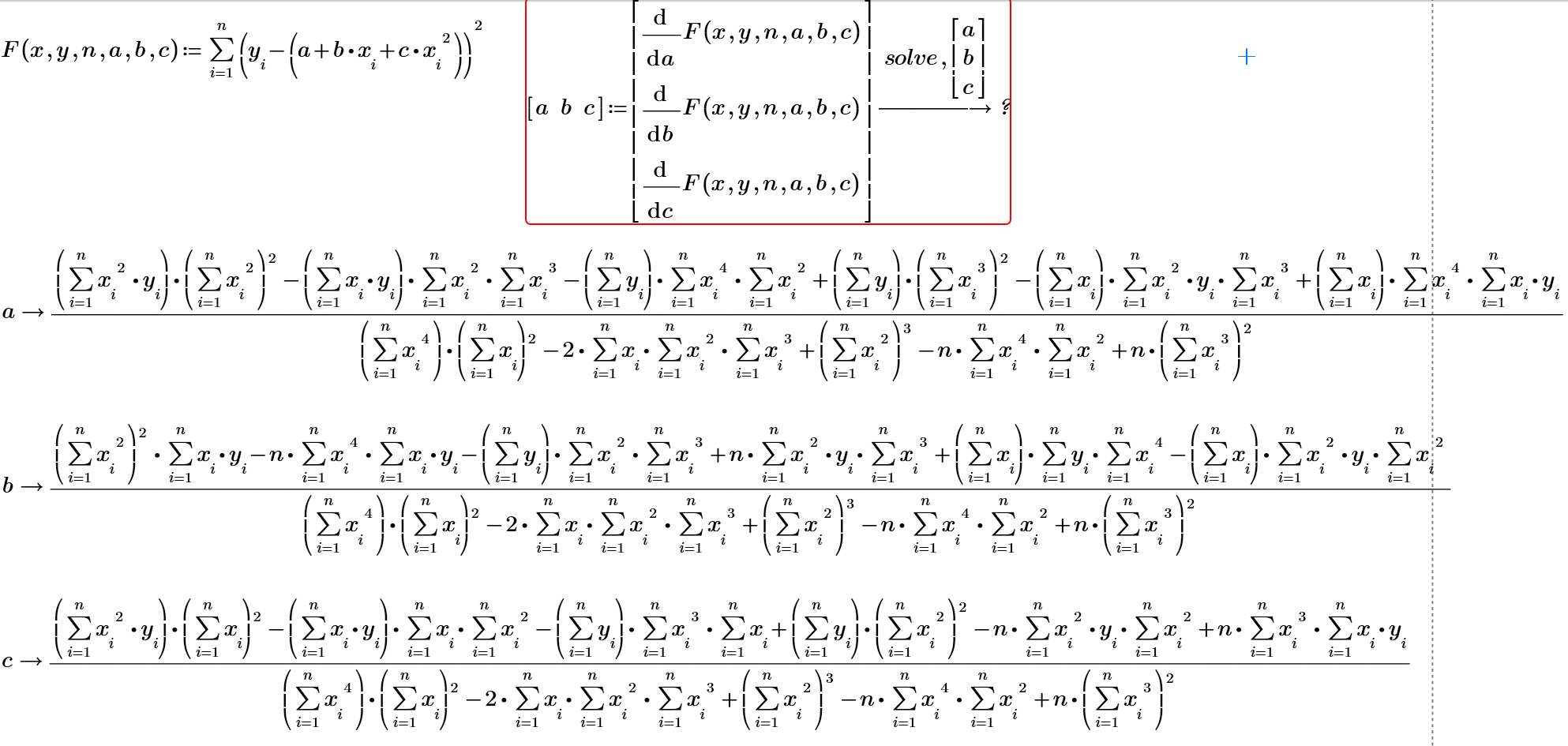

A function with 3 arguments and a symbolic solution
