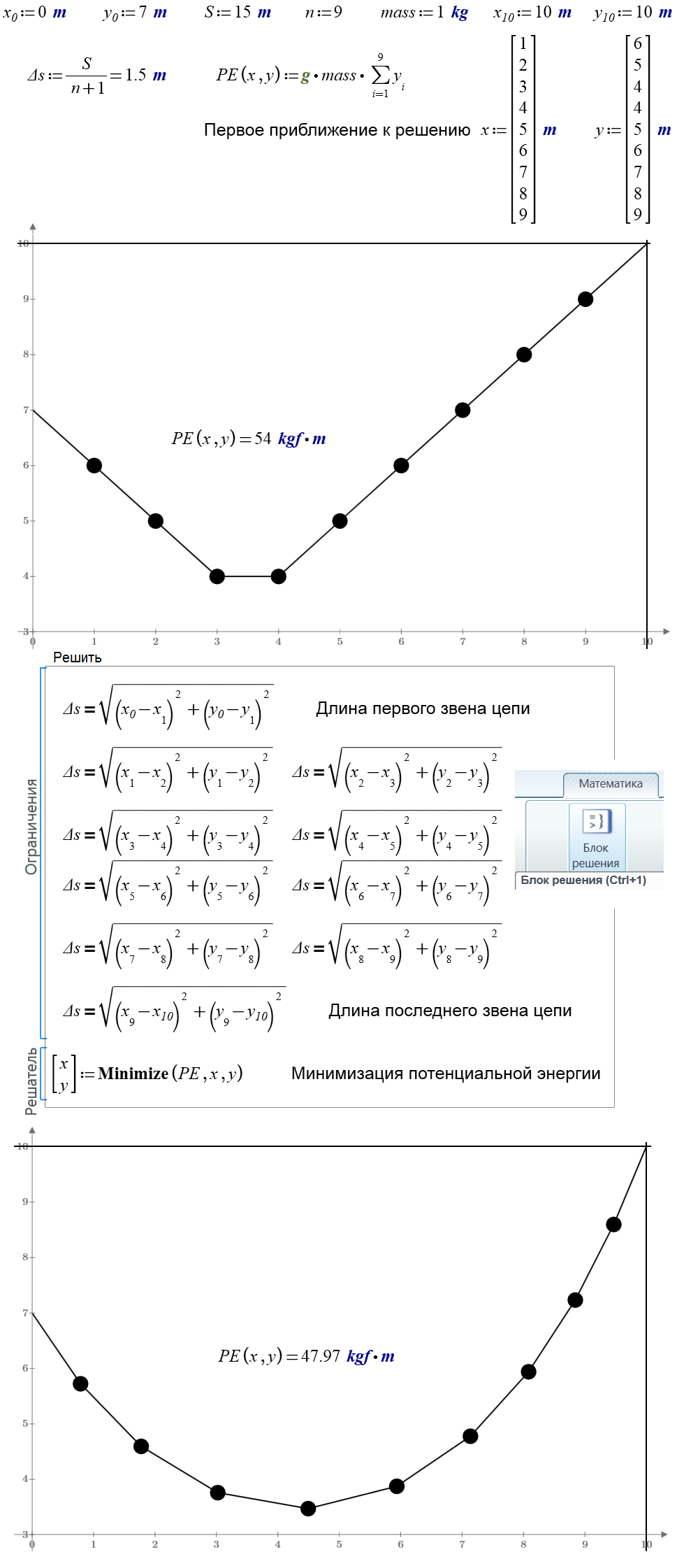

We can use a vector as an argument of the Minimize function
