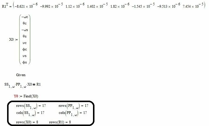

Hi, In the attached sheet Minimize is not working correctly. The Minimize value given changes to the Guess value all the time giving an incorrect result. Further in the sheet I am using Find to solve a matrix equation and then using this result in a subsequent calculation (Transfer Matrix method). The first Find calculation seems to work but the second identical calc throws an undefined variable error, cannot see why. Any assistance would be appreciated. thanks Ross

Your first solve block has a function of omega. Your second solve block has no function, so Mathcad has no variable that it can change. The error message is misleading. Since version 12, this is the only error message a solve block spits out, regardless of what the problem actually is. This serious bug has been around for at least a decade, but neither Mathsoft nor PTC could be (or in the case of PTC, can be) bothered to fix it. A solve block has to have a function of a variable, or variables, that the solve block can change to find a solution.

I fear that something is wrong with the size of the matrices.
@-MFra- wrote: something is wrong with the size of the matrices.
Yeah. I should have noticed that. It was getting late though Smiley LOL
remslie14-AlexandriteAuthor
MF, Richard, That's a touch embarrassing. In fact whilst I was noodling over the problem just before your responses I discovered the fact that the matrices are of different size. I have corrected that but I am still having problems. I will spend a little more time trying to rectify before summoning further assistance.
