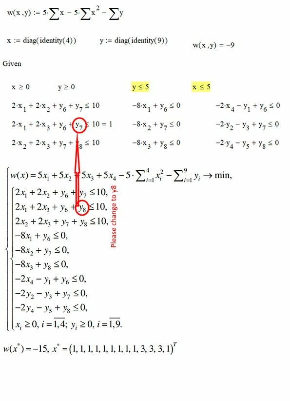

Would anyone be so kind as to point out to me why the MInimize function does not work in this system of equations?
The answer it should give for the variables are: 1, 1, 1, 1, 1, 1, 1, 1, 1, 3, 3, 3, 1.
Thank you very much!

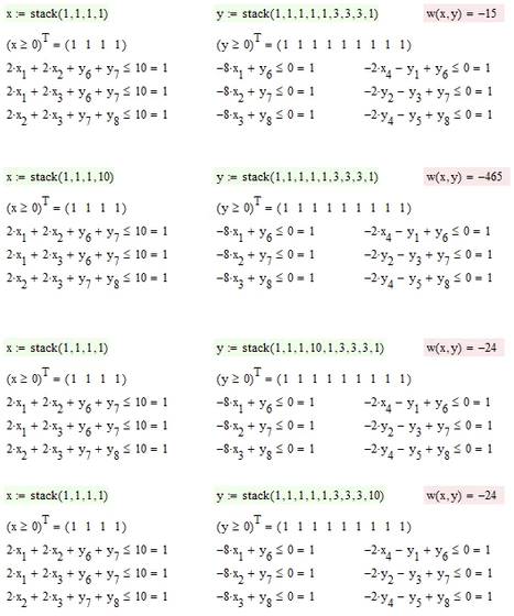

You sure have already noticed that the changes you suggest still give a much better (lower) solution that the one you expect:

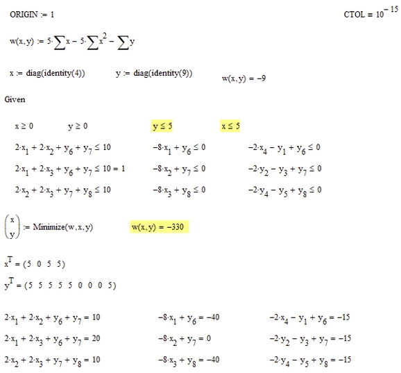

There is something wrong either with your function or with your constraints.
The value of w can be made as low as you wish without violating the constraints! Thats the reason why Mathcad can't find a minimum - the error message about a variable not being defined is nonsense but its the only error message a solve block will ever throw.
The picture shows the elements of x and y which can be enlarged for a lower function value:

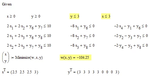

If I add an upper limit for the values in the vectors, the solve block gives a solution, but not the one you expected. So I guess you'll have to check your constraints.
Mathcad15 file attached.
Thanks Werner for your answer.
Please make the change of the variable in the equation indicated.
One question:
Can the objective function be worked with a single variable, w(x)?CR_Min_90121.jpg
