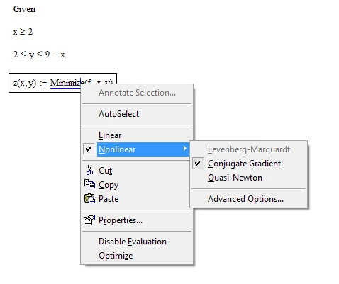

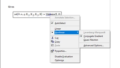

I am trying to find the local minimum of a function using Minimize function in Mathcad 15. I would like to use the Levenberg-Marquardt algorithm. However, I am unable to select this option from the menu, see the image below.
Please let me know if it is poosible with Minimize function.

From Mathcad (11) Help. I suspect Mathcad 15 will be little different:
"Conjugate gradient method for solving
The Conjugate Gradient method is one of the nonlinear methods to use with the find, minerr, minimize, and maximize functions.
Means that the Conjugate gradient method can be used for Minimize.
"Levenberg-Marquardt
The iterative Levenberg-Marquardt method can be used during the solving process called by find, or minerr.
Means that the LM method canNOT be used for Minimize.
July 22, 2021
Mathcad 15:
