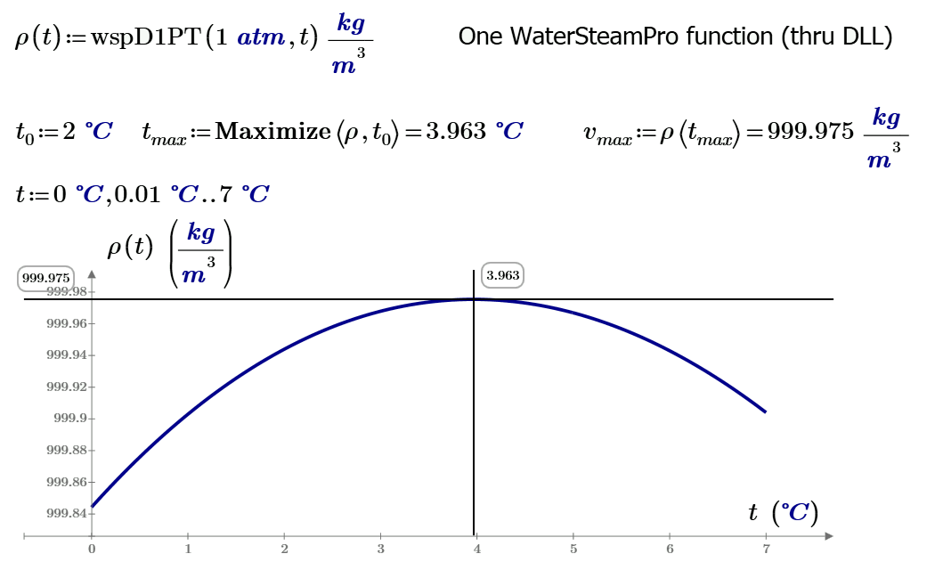

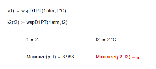

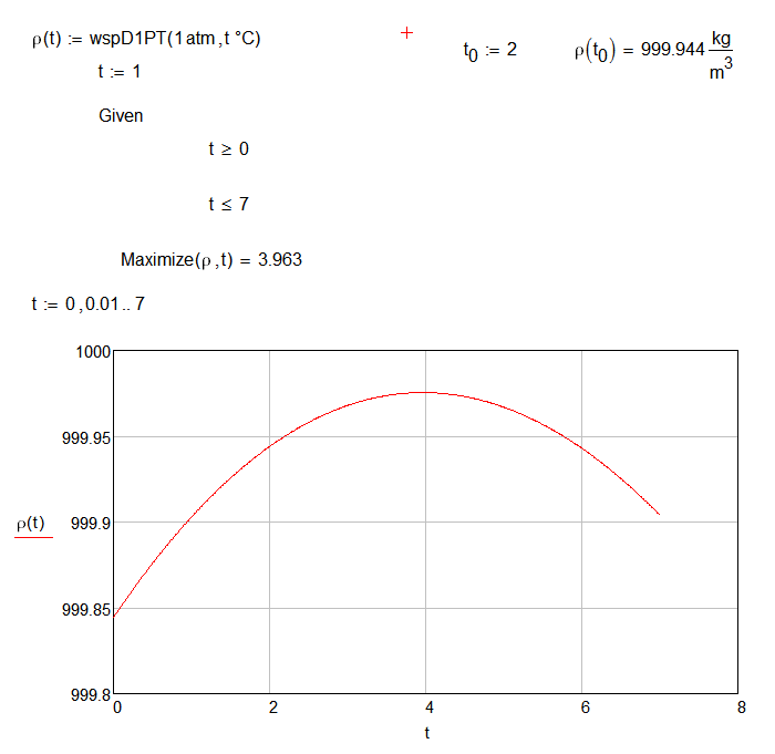

Two changes are needed in the MC15 file. First, the Maximize function needs to be part of a Solve block. Second, it can't use units with the independent variable.Maximize.png
Nov 2, 2014 8:43 AM UTC
Thanks and sorry
The Maximize function needs to be part of a Solve block only in Prime 1 & 2.
See the top of my Mathcad 15 file.
And in Prime - no problem - see please second picture above
Nov 2, 2014 8:48 AM UTC
I think it is one units bug in Mathcad 15. In Prime - all is OK here with units!

Huuuh!! Whats that?? A late Halloween trick? Sure something for your Mathcad Madhouse collection, Valery.
Just adding +0 to your function rho makes the Maximize() function work correctly.
Not sure but it may have something to do with the fact, that for invalid (neagtive) temperatures we get now an invalid result rather than the string which your function would return.

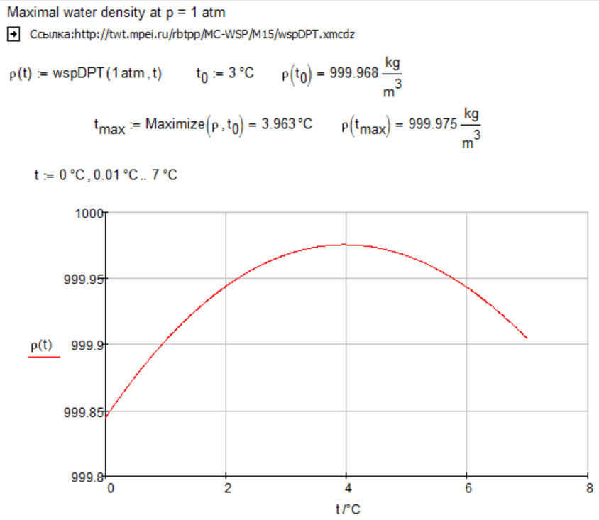

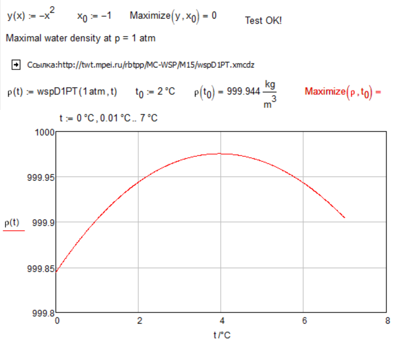

Nov 2, 2014 6:28 PM UTC
Yes. I think the problem is in my function wspD1PT (Region1 of the IAPWS-IF97 - water). Sometimes it returns string.
No problem with the wspDPT function (all regions):

Nov 2, 2014 5:16 PM UTC

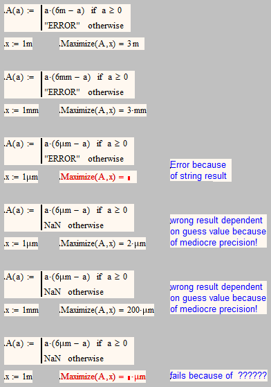

OK, now it seems to be clear that the real problem is the string which the function returns in case of a negative temperature. When using units in numerical algorithm Mathcad usually uses different step sizes, different precision (we had this a few times in the past) and that may be the reason we are not running into this problem with Harvey's workaround whith a unitless independent variable.
When I replace Valery's error string by anything else - here a NaN but it could be 0 or even 1/0!! - Maximize works OK.
But ...... can anybody explain why maximize() still fails when I use IsString() instead of testing for the exact error string???

Here is some additional baublery with Maximize and units.
Even if we may not call it a bug it sure can be called a very bad implementation. At least the reference (OK, there is no reference since M12) and the help should point out that the function should be used unitless.
Nov 3, 2014 1:08 AM UTC
I know that this has been answered, but I think this might be useful. I think the problem in MC15 is that the deg C unit is not truly a unit...it is a function. Note that my earlier suggestions changed the function so that the variable was unitless, and the deg C function was applied in the density argument. Also note that the only example involving deg C that Werner gave that got the right answer when the independent variable had deg C as a " unit" was the one that had deg C eliminated by cancelation of numerator and denominator.
Further, look at the following comparison:
Note that the lack of conctraints is not the issue as I had earlier suggested.. It appears that the difference is the independent arguement. Werner has shown that the independent variable can have units, but in this case deg C is not a unit. Apparently this got changed for Prime.

Harvey, as already written I guess that the unit is responsible for the numeric algorithm taking larger steps and this may lead to inaccurate results. In our case it also seems to be responsible for the algorithm to try negative values for t2. But the unit is not responsible for Maximize to fail.
The real reason for Minimize to fail in this example is because Valery's function is returning a string for negative temperatures, Slightly change the function rho2 in your example above: just add "+0" at the end. This will not change any valid result but now for negative temperatures this function fails because it can't add a string and a number. Using this function makes Maximize() work - regardless of the unit °C.

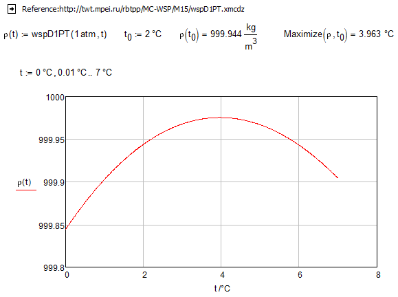

Nov 7, 2014 12:00 PM UTC
Valery Ochkov wrote:
I have an error by using Minimize & Maximize in Mathcad 15.
It is more better not download any Mathcad-function on your computer but do a link on clowd Mathcad-function.
Wen I see an error in my cloud Mathcad-function (in wspD1PT for ezample) I correct it and now problem over the World
Compare pls old (above) and new (below) Mathcad worksheet with a reference on the cloud function:
