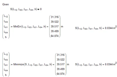

Whats wrong with minimize?
Anyway, here is the simplest way of doing it with minerr (you'll have to chose Quasi-Newton as algorithm to get the very same results as with minimze):
BTW, it looks like you are using a 4K display like me. Pictures you grab from hat screen are far to large to be inserted here, making the threads hard to read. You should either resize the pics before posting or choose "medium" as size when you insert them in a thread.

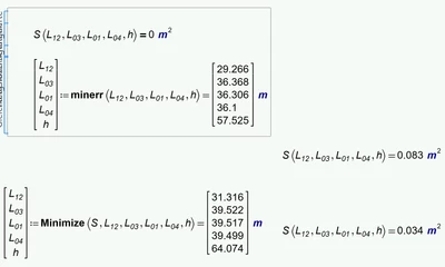

February 4, 2018
Just gave it a try in Prime4
You have no choice of algorithm
Calculation with minerr takes "endless" time
Result is not as good as the one derived with minimize
Facit: Avoid using Prime whenever possible (and its always possible to avoid).

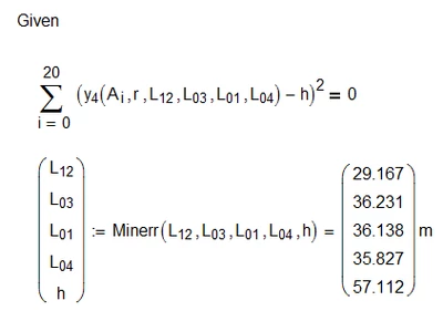

February 4, 2018
Thanks, Werner!
But I think about this method

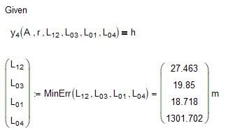

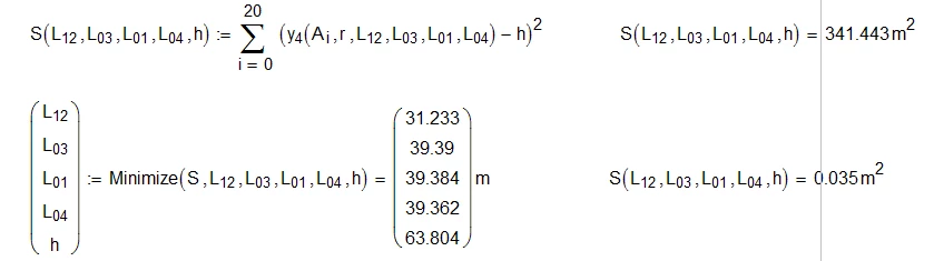

February 5, 2018
S=?
23-Emerald I
February 5, 2018
You defined S as the error function, so minimizing it gave your answers.
Find and Minerr act to satisfy constraints, so finding the minimum error for y(...) = h has the same effect.
Note that Minerr is basically Find where Find can't arrive at an acceptable solution.  It's always wise to find out how bad your "minimum error" is, it can be quite unacceptable.
