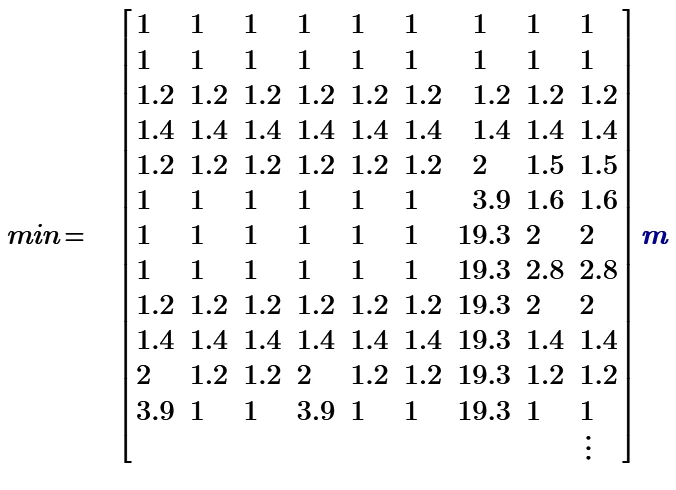

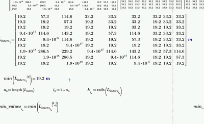

I need to take this sheet a step further.  Now after we get 24 matrics . I need to find the minimum value in each column in each matrix.
For example: matrix Linters 23 will have a matrix of the minimum values of each colunm . I tried to do it as follows but couldn't get what i want since it gives me the minimum in the whole matrix . I need  the minimum in each column in each matrix.
Like in excel you select the colunum and find the minimum in that column. Sorry for bothering you a lot. But I genuinely appreciate your help

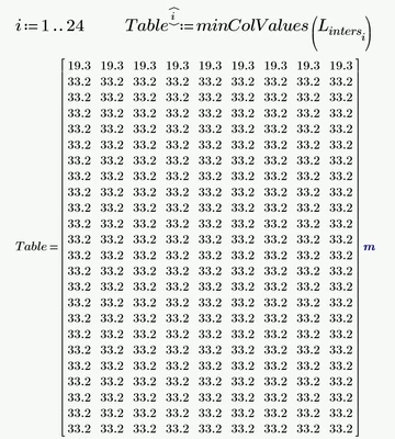

You could use a utility function which take a matrix as its input and returns a row vector with the minimum values of each column
You may apply this function to individual matrices of L.inters
or create a table with all 24 rows
You may create the very same table in on go, too

Werner_E25-Diamond IAnswer

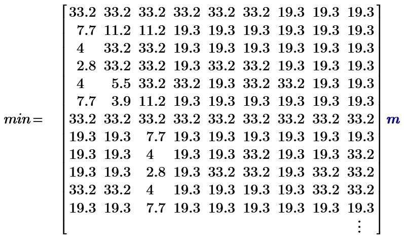

Why I'm getting zeros here ?
Actually zeros mean the function doesn't apply in Linteres ...I want to get the minimum value except for zero. the nearest minimum value
I should get the minimum value of each column in each matrix

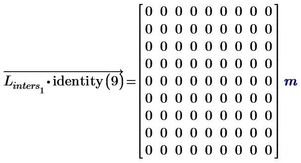

ttokoro
Identity of L intes[1 are all 0. So, min are all 0. If max you get below.
If you want mimimum but not 0, select the next data by sorting. 0 data should appear each only one time is assumed.
