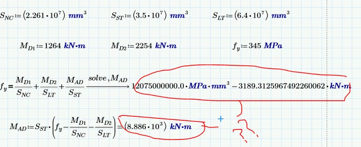

And what about mismatching units?

At first, I got J in unit after the evaluation by =.
It can change to kN*m by using keyboard, manually.
