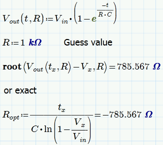

Here is a different approach using two solve blocks, one with odesolve, the second with find.
I get a different value for the resistor (785.57 ohm, compared to Fred's 710.94 ohm) , though, haven't checked why.
EDIT: Just used the easy to find exact solution of the ODE and found the correct value for the restistor again with 785.57 ohm! Not sure whats the problem in Fred's sheet.
EDIT2: Found the problem in Fred's approach. It was a simple precison problem because of the rather small time values used. Match() would find a couple of matches within the given tolerance and the first one of this list is not the best one. See my other reply to Fred's post for details and solution.

Adrien Thurin wrote:
Interesting, your approach is much closer to what I "instinctively" wanted to do, except that your syntax works !
Yes, you approach was quit intuitive but unfortunately thats no the way Prime works.
The points (apart from using the boolean = instead of the assignment := for equations) to consider are:
  • If you use an unknown in a solve block you have to solve for it even if you just use as a shortcut and are not interested in. So its OK if you use I(t) as you had done, but then you would have to provide a initial condition I(0)=.. and must let Odesolve solve for I(t). You have to treat is as a system of ODEs. Thats the reason I have omitted I(t) - if I(t) is needed after you have found the correct value of the resistor it can very easy be defined using the now (numerically) "known" V.out(t).
  • The second point is that you tried to use just one solve block which would be nice if we could do so, But because V.out(t) is an unknown you must search for it and because its a function we cannot use find() like for finding R but odesolve. This fact forces us to use two different solve blocks. Fred showed a different approach and solved for V.out using one of the standalone command line solvers.
