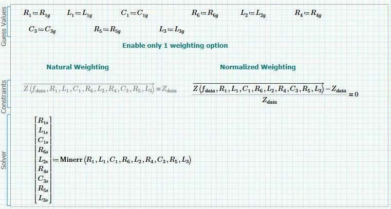

Would Minerr help?  In this example Z is a function that is the output you are after.  Z_data is a set of data.  Mathcad optimizes the variables to find the minimum error.

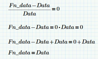

I'm sorry, but aren't your two weightings the same?
Some simple algebra manipulation of "Normalized weighting' results in "Natural weighting."
What did I miss?
You are right, one good approach (especially with emperical data) is Minerr!
November 21, 2017
Except that nothing actually equals zero since it's (in my case) a fit of data.  We're just trying to get close to zero.   I certainly get different answers with the two methods.
