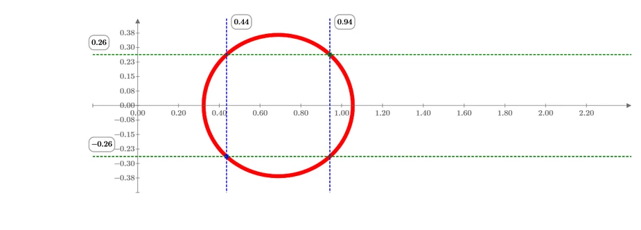

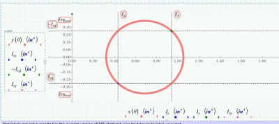

If you read the error:
You need to put on the marker:
The markers on the plot needs to be unitless...as the red error is suggested: "Markers are unitless".
Cornel19-TanzaniteAnswer
Oct 23, 2023 1:10 PM UTC
SFares14-AlexandriteAuthor
Oct 23, 2023 1:41 PM UTC
Thanks a lot Cornel!
