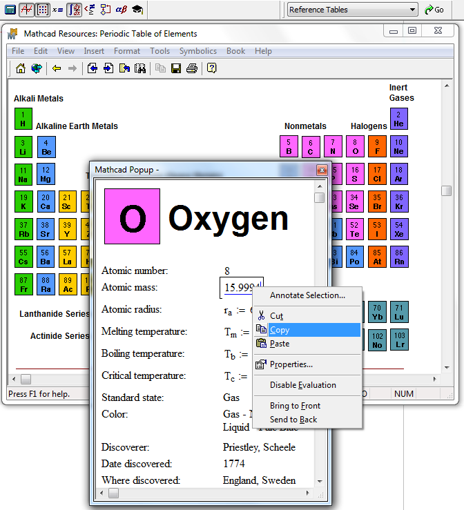

In Mathcad 15:
23-Emerald V

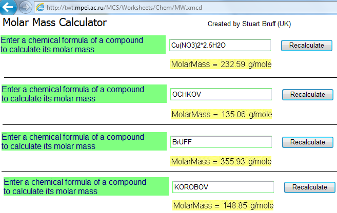

Do you mean something like the attached? (Needs work to handle molecular formulae with parentheses).
Stuart

June 29, 2012
Now on the MCS too - http://twt.mpei.ac.ru/MCS/Worksheets/Chem/MW.xmcd
