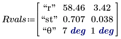

I'm hoping that someone may be able to help me with a monte carlo simulation problem. The function I wish to use has a root within it, which gives me an error. As soon as I remove the root from the function and use the rest of the equation, as my function it works, but obviously giving incorrect results.
Ive attached the baisc problem, if anyone can help
Richie

You could use the absolute value in the root to avoid roots from negative values
But I suspect that you rather meant the angle theta and its standard deviaton to be in degree?
