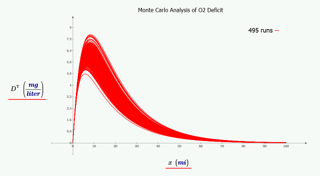

     This worksheet using PTC Mathcad provides you with the basic Streeter Phelps equation which allows for the calculation of the dissolved oxygen deficit in a stream or river as a function of the distance downstream. The result is a function of the two kinetic constants, reaeration constant and the deoxygenation constant. After these values are calculated you can plot each "run" on the same set of axes.
     It can be argued that a distribution of plots more accurately represents the real world. Next, the worksheet solves how the resulting deficits are distributed for a specific downstream distance. You can answer this by extracting the deficit computed for each run at the specific distance and plotting the values as a histogram.
     The worksheet calculates this with mile 40 of the data provided. After you've evaluated whether the 0₂ deficit at any specific distance downstream is about normally distributed, you can compute the mean deficit at each downstream distance. You can also find the standard deviation and the mean plus/minus 3SD which provides the range over which 95% of computed deficits should fall.
