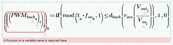

I guess the next question is : What am I doing wrong in declaring my nested matrix ? A general declaration with all indexes varying doesn't seem to work. I assume a loop would do it, but that's a bit of a pain.
(Assuming i,j,k,u, Vin,Vout,fsw and t are defined properly)
Jan 22, 2015 6:42 AM UTC
One exapmple of 3D-matrix and its interpolation
http://twt.mpei.ac.ru/ochkov/Mathcad_12/4_04_4D_Spline.png

Out of curiosity how do you create a blank line (first row) in matrix 2 and 3?
Jan 22, 2015 6:33 PM UTC
We must have a 2x3 or 2x4 matrix and inert (copy and paste) vectors and matrix.
