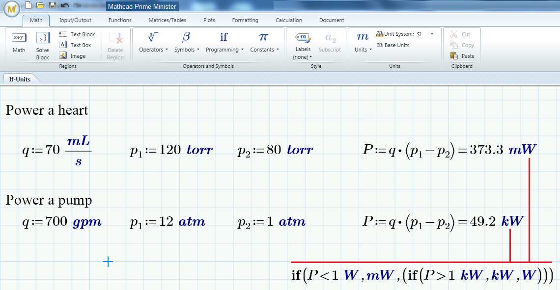

I would iike to have units implemented so that I can pick a base unit and any SI multiplier.
April 18, 2012
I fully agree. I also would like tables to be able to display the unit of my choice, not only SI units.
Mike
April 18, 2012
I assume by "display" you mean "automatically display". Can you not choose a unit system in Prime? I have never looked, because I always use SI..
April 18, 2012
I think the best "more units" in Prime 3.0 will bee so - http://communities.ptc.com/docs/DOC-2152
See the picture too:
http://communities.ptc.com/servlet/JiveServlet/downloadImage/102-2152-1-25787/450-232/If-Units.png
