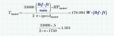

I'm trying to calculate motor torque using a standard equation that includes a constant that obviously has units associated with it, but are not named.
I've pasted an image of the M' sheet as well as attaching the sheet in XPS format.
The basic motor torque formula uses the constant 33000. Does anyone know off hand what units I would need to give this to make the formula come out corredtly? The output is lbf-ft. I did the unit-less calculation underneath the formula so show what the answer should be.

Stuart,
I guess I have to start thinking more out of the box... Your reply gave me an idea...
if M' knows how to convert hp to lbf-ft/min then maybe I dont need the formula anyway. If just let M' do the converting...hmmm
So simply deviding the hp but the speed yields the correct answer...!

It is an interesting observation that I hp = 33,0000 lbf-ft per minute.

Stuart,
I do believe that this is where the number comes from, but if I simply add lbf-ft/min to the equation, I still do not get the correct answer. I now get an answer with Watts in it...
Sep 13, 2012 2:23 PM UTC
Because you are using units the conversion factors are no longer required & do cause the calculation to go significantly wrong.
