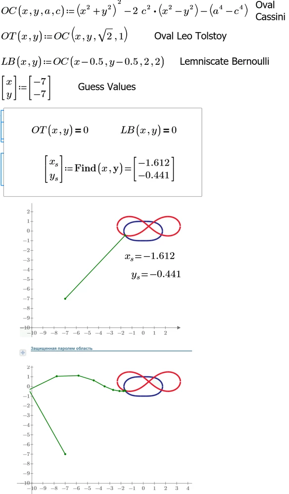

Who's to guess what's in a protected area? Prime 6 in attach. We have some tools in Mathcad 15 (trace)

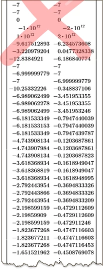

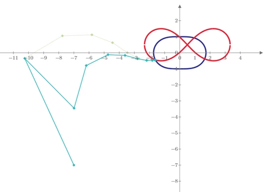

Yes, the trace command in MC15 was quite useful and is missed in Prime.
But your approach seems to be in no way a suitable replacement for it because you are cheating!
Your picture does not show what the built-in "find" command is doing but is rather showing the attempts of a different(!) algorithm which you implemented yourself - probably one of those you already posted a few times in the past.
The correct path chosen by Prime's algorithm can be seen in the following screen shot in turquoise (yours is shown in light green for comparison).
I omitted the few first values where Prime tries the result of the origin, some "extremes" and comes back to the initial values

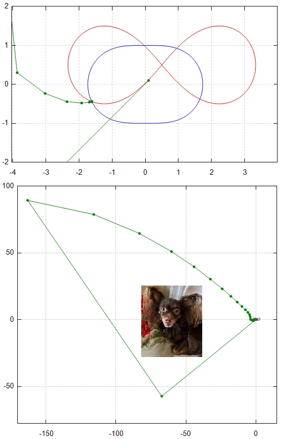

My dog named Snif approaches the food bowl in such a way - he never goes straight, but takes a big detour. I have asked him many times why he does this. He is silent.
