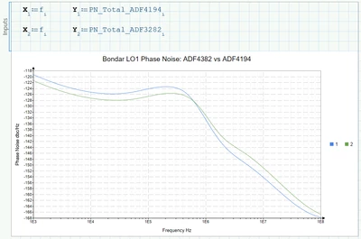

Hello Mathcadeers,
I could not find a way to properly set the Legend on "Chart Component". The legend only shows "1" and "2". Can I set it up to show the actual name; eg PN_Total_ADF4194 and etc?
Ak

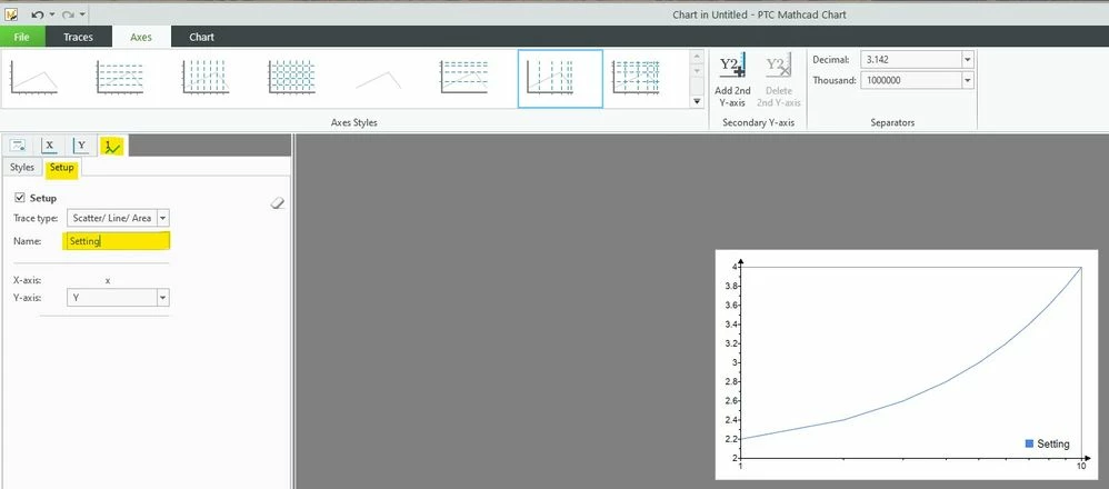

Hi
Double click on the chart to bring up the format editor.
In the format editor the two lines on the chart will have a tab in the editor.
Select the tabs one after the other and change the name.
The legend changes to match the names chosen
