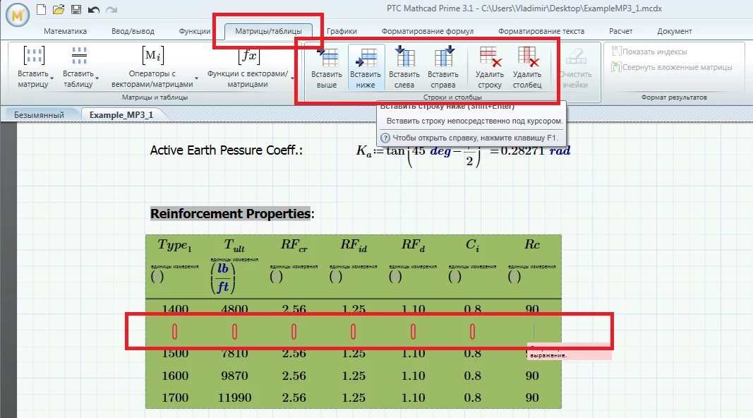

I have prepared for you a Mathcad Prime 3.1 document, Where all the calculations have been transferred from Excel into Mathcad Prime. If you need to add new data in an initial table, then use the tab "Matrix/table" and commands from panel "Rows and columns":
