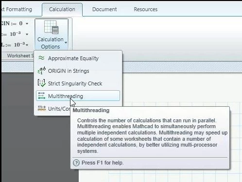

I have an Excel file with thousand of cases. The inputs of each case are sent to Mathcad through its API, and the results are sent back to the Excel file. This process is repeated sequentially, solving each case one-by-one. As you can imagine, it takes several hours to finish all cases.
I wonder if there is an option to use multithreading/parallel programming to solve several cases simultaneously and speed up this process.
Also, is there an API command that returns TRUE or FALSE if Mathcad is busy calculating? At the moment I am waiting a fixed amount of time (15 seconds) between cases. Maybe I can ask each second if Mathcad is calculating until it is not and then extract the output values.

It is unclear what happens when several files are open at once with independent calculations.
You could put several independent load cases in one sheet.  Say ten at a time, then the ten would run in separate threads.
Does multithreading only work on the one sheet?
You could try setting the multithreading calculation option and opening several files at once and see if they solve together.

Thanks for the reply. I am using the multithreading option and the time per case is significantly reduced by half. That's good.
Do you know which API command is able to do what you mention? I couldn't find it in the documentation. Thanks!

I can't find the message though. I basically wonder if there is a way to know through the API if Mathcad Prime is busy calculating? I can't find it through the documentation. My idea is to change imposing a fixed time per case for a dynamic time dependent on how long Mathcad takes per calculation.
