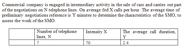

Hello dear forum members here is my working hours just do not know whether it is correct, if not correct, correct, please, who is not too much trouble, I will be very grateful, and then in the address of my longer forest messages arrive. You should not think me lazy just big trouble with math and Mathcad, as well as there are many other significant problems. Please, if not more difficult, please write a comment, it is desirable to every line well in the sense of what is happening at each stage.

comments in attached.

Here is a new sheet - typo corrected and added some probabilities.
Still not sure what Q, A and K should be. Q look like service factor of model with limited population, but not sure about that.
