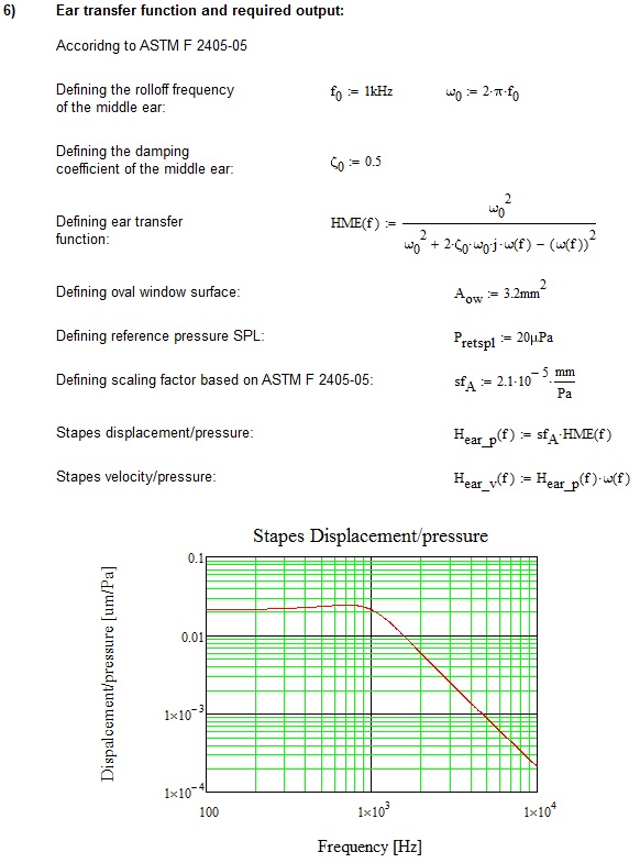

Ideally I would call the file (add as a reference?) and just let it spit out my power consumption. The model I have only calculates instantaneous power. So I have to loop it for all the time frames of my input file. I've attached one of the pages from my inherited model, as requested.

I'm having trouble relating your expaination at the top to your picture.What in the picture changes based on a time sample; your page looks to be self-contained without any external references.

So I agree, there are no external references. This is from the power calculation worksheet (6/10), I thought that is what was asked for.
