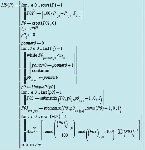

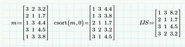

Multiple column sorting
It is easy using the csort(M,n) command but it only operates on one column.
Is there an easy way to sort on first two columns.
Also need to add if first two columns are identical ?

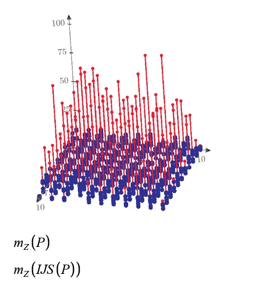

ttokoro
Oct 10, 2024 12:42 AM UTC
terryhendicott
Oct 10, 2024 1:16 AM UTC
Thank you @ttokoro this is excellent.
Cheers
Terry
ttokoro
Oct 10, 2024 4:50 AM UTC
x=0 and/or y=0 can treat. Bug fixed. Now P with 10,000 rows can treat by IJS(P) function.
