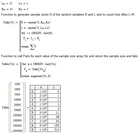

I have created a programme for Mone Carlo Simulations but now want to get an output table to show what would happen if I created more and more simulations.
In the attached file the basic problem is using 1000 simulations which returns 0 failures in my problem. However, I want to see what happens as the number of simulations (Nsim) increases i.e. I want a table with Nsim in one column increasing and the number of failures in another column also increasing.
Any help really appreciated.

Sothing like this?
23-Emerald V

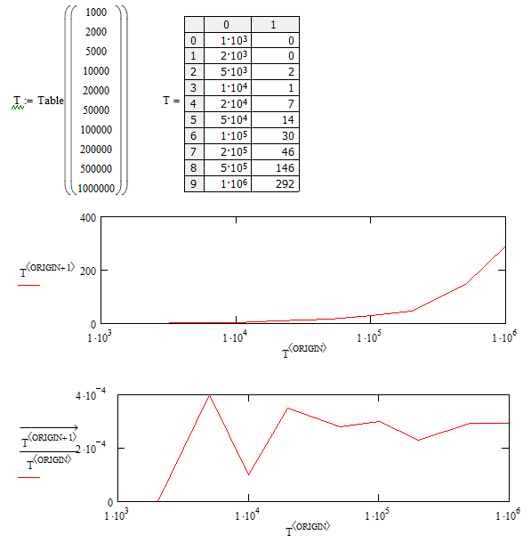

This is the type of output you could get:
