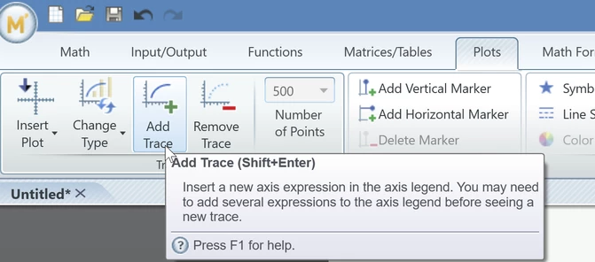

Hello @LucMeekes ! I am using prime 9.0.0 and I cannot seem to find an option to add multiple entries to a single plot like in this answer. I can just copy and paste the plot you generated, and it works, but I would like to know how it is done, please 🙂

To add a trace you may use the "Add Trace" button on the "Plots" ribbon or (more convenient) the keyboard shortcut "Shift+Enter".
