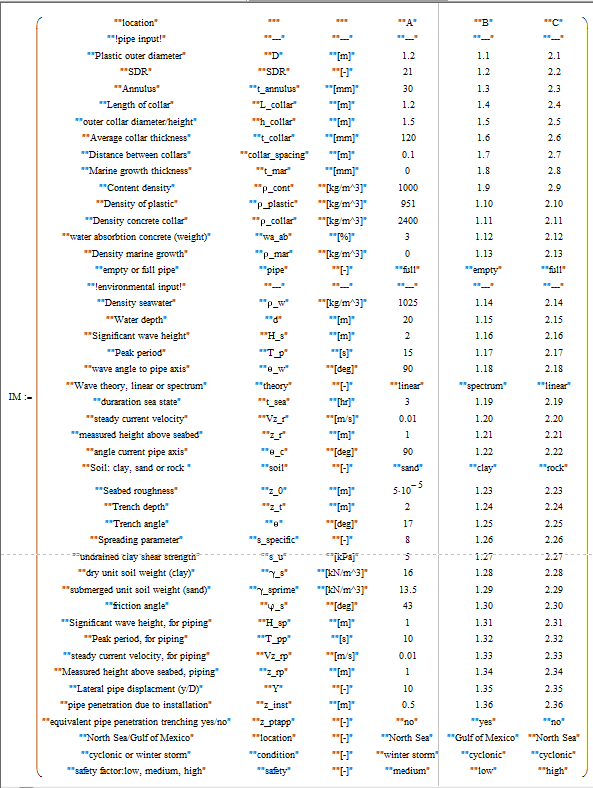

I made an elaborate Mathcad 15 sheet about the offshore pipeline stability according to the DNV code. The sheet turned out to be very elaborate abouth 25 pages of calculations, including iterations, interpolation in tables etc. The sheet works fine and I am very happy with the sheet .
However, I would now like expand this sheet so that I can see the stability of the pipeline at multiple locations in the same sheet. I would like to avoid saving my sheet for one location and then save another for another location. I thouhgt of these options:
  1. Copy paste everyting in the sheet in a new area in the sheet basically do everything more than once. This is an very ugly method but at least I know this will eventually work.
  2. making a matrix of my input and output. However this does not contribute to the readability of the sheet and I am not sure if I am able to rewrite all formulas for matrices (iterarations in particular).
  3. Making a function of actually the entire sheet. Is this possible if you have iterations? as well
What do you guys suggest how I should tackle this problem? Do you have better solutions to the ones I have stated above?
As an example of how elaborate my sheet is I have attached an input matrix I had already constructed:
Thanks in advance.

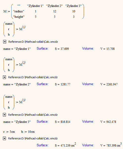

Here is an alternative method which follows the line of copying the calculations multiple times (but without really doing so).
You simply set up two worksheets. The first one (I called it "Calc") would be your 25 page sheet but without the variables defined you want to change. Don't mind the red errors for now.
Example of Calc.xmcdz:
Now create another worksheet, define the variables, insert a reference to Calc.xmcdz and display the calculation result. Then define the next set of variables, insert the next reference, etc.
Inserting a reference acts like you copy the content of that file in that place of your new worksheet. You could as well put your calculations in a collapsed area and copy this area multiple times, but then you will have more work if you need to change something in your calculations as you will have to do the copying again. The drawback of a reference on the other side is that you have to handle and keep together two different files.
As you probavly use units the method with the matrix consisting of all variable sets will not work in Mathcad 15 and below because we are not allowed to keep values of different dimensions in one matrix. But is should be no problem to provide the values singly as shown in the last example below or you may use a single vector for each variable:

Dec 22, 2014 1:29 PM UTC
Thanks a lot Werner, this is really really helpfull, I am implementing it now. The disadvantage of using two sheets really outway the advantage. Thank you.
