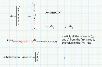

I need to multiple selective values in a matrix with selective values in another matrix . I used ( submatrix function ) however it didn't work :
where m is a row number
Here I want mathcad to multiple the first three values from both d and z
Can you help me doing this ? the sheet is attached

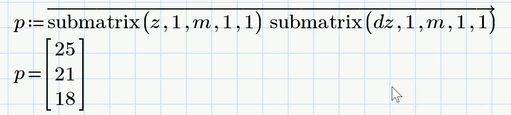

Sorry Yusra used subscript "1" not subscript "i" for z
Correction:-
Cheers
Terry
14 replies
terryhendicott
Like this Yusra:-

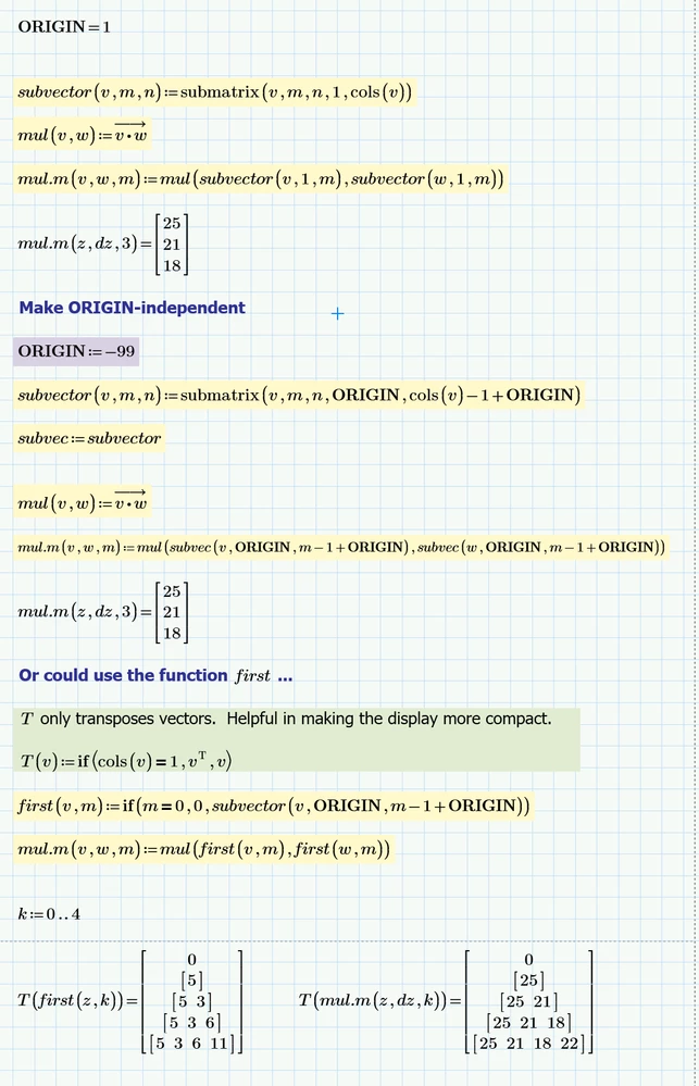

You already got your solution. I just wanted to explain why your approach did not work. Reason is that you used the vectors which are created as a subscript - hence the error message as a subscript must be an integer.
Your approach works OK if you just multliply the results of the subscript functions.
Here the vector dot product is used by Prime:
If you had an element-wise multiplication in mind so the result is again a vector, you would have to use vectorization:
But I am a little irritated as you use a value in vector dz as the number of elements to multiply. What if you would have chosen m:=dz2 instead of m:=dz3 ?? Obviously its not possible to multiply the first seven elements as dz contains only six elements. You may replace  m  by  min(m, last(z), last(dz)   to cope with this.
And I sure agree with Stuart that using a function to do the job could be quite beneficial.

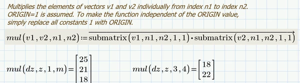

You may use a more generic one which multiplies a contiguous range given the start and end index:

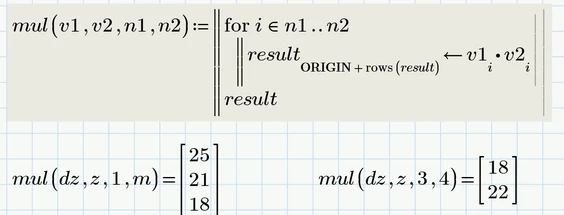

Or you could do without submatrix and vectorization by using a simple for-loop
Both functions don't use any error checking as of invalid indices...

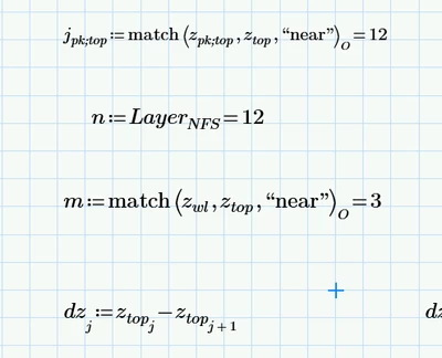

Thank you Werner. actually in my original sheet m is not a simple number . It is also a function . I wonder if  I can use the submatrix function in matrix index
Hopefully a function that returns an integer in the range from 1 to the length of the smaller of the two vectors.
Sorry, its not clear to me what this should mean and also not how it would relate to the picture you posted.
The submatrix function always returns a vector or matrix but the index for a matrix always must be a simple integer.
