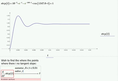

I am having troubles getting multiple solutions for this system (with an underdamped response).
I am using PTC MathCad Prime 5.0
Does anyone have suggestions?
It works to use the root function, within a specific interval, but this function does not return all the solutions. I would like an way to get the solutions without necessarily knowing the interval.

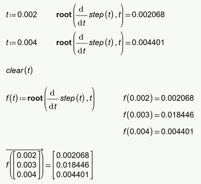

Using the root function with a guess value has the drawback, that you don't necessarily get a solution near the guess as you can see in the picture below with the guess 0.003.

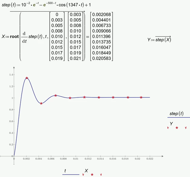

So probably in your case its more appropriate to use the "root" function by providing a range:

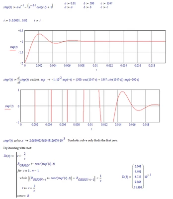

This should do it:
